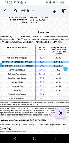

miriam says microinverters have grid-forming.
IQ8 does have, not iq7.

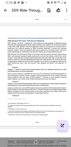

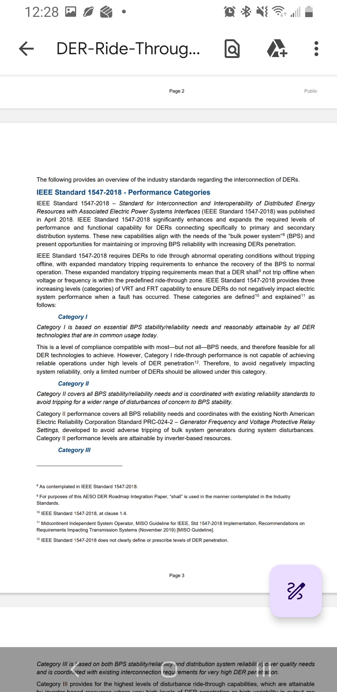

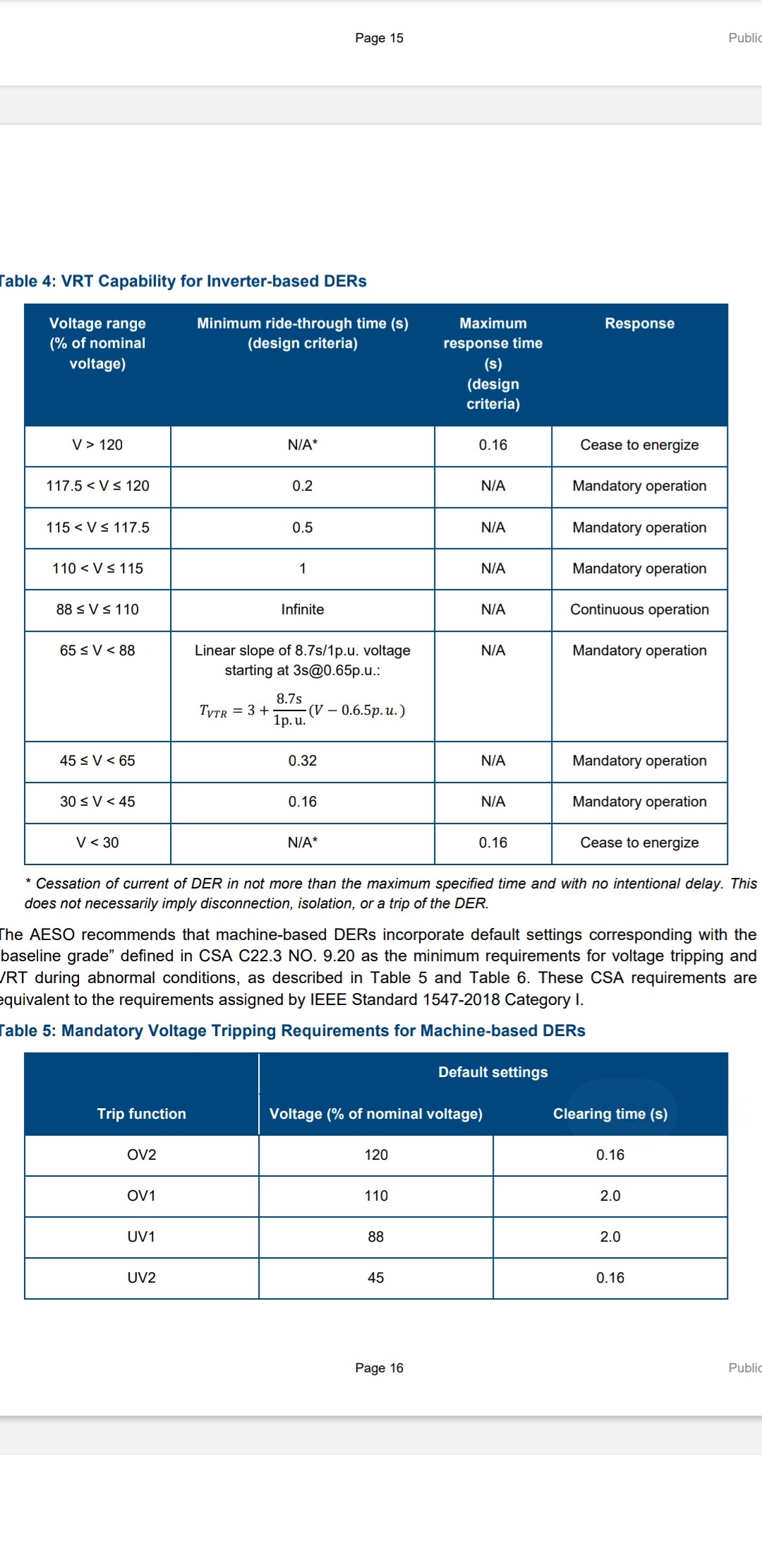

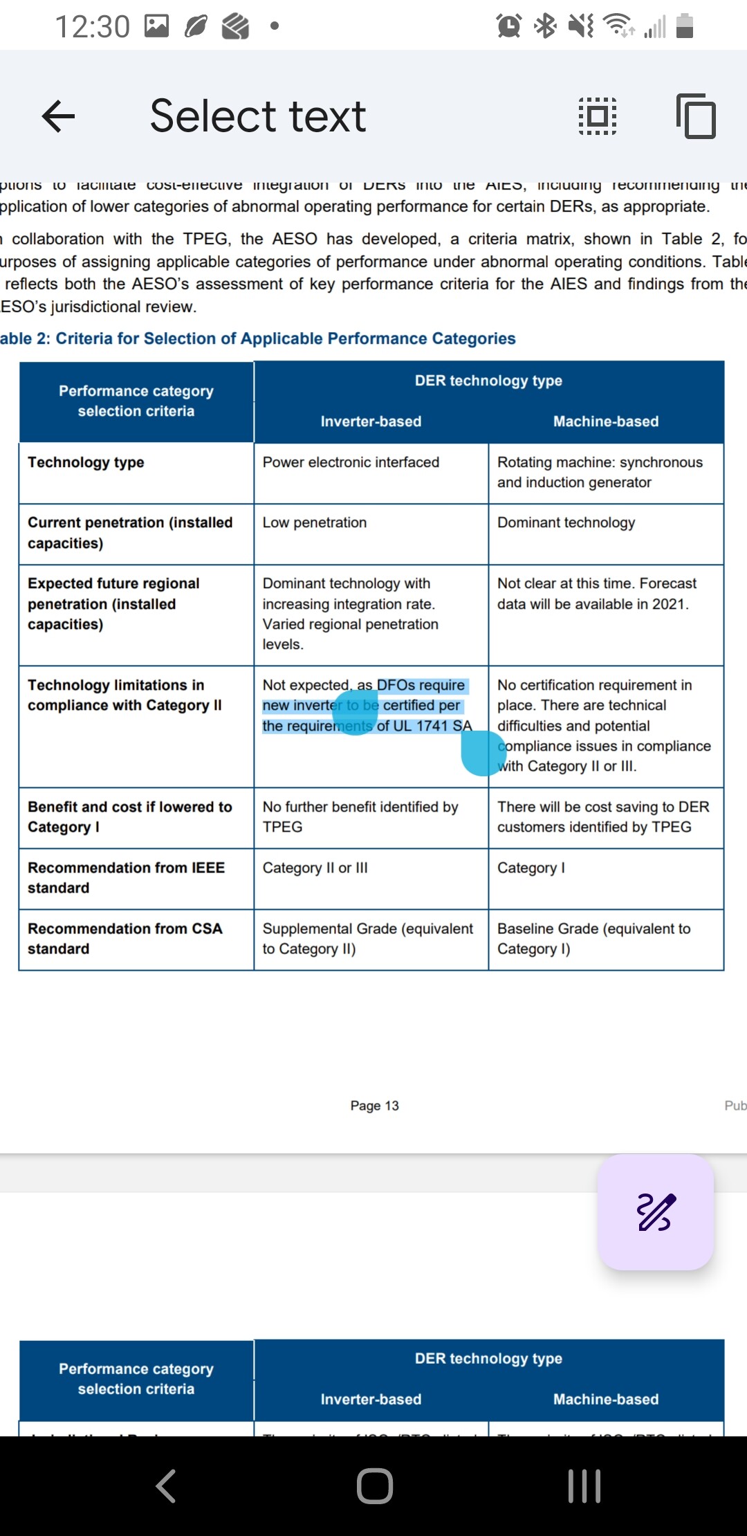

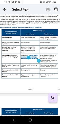

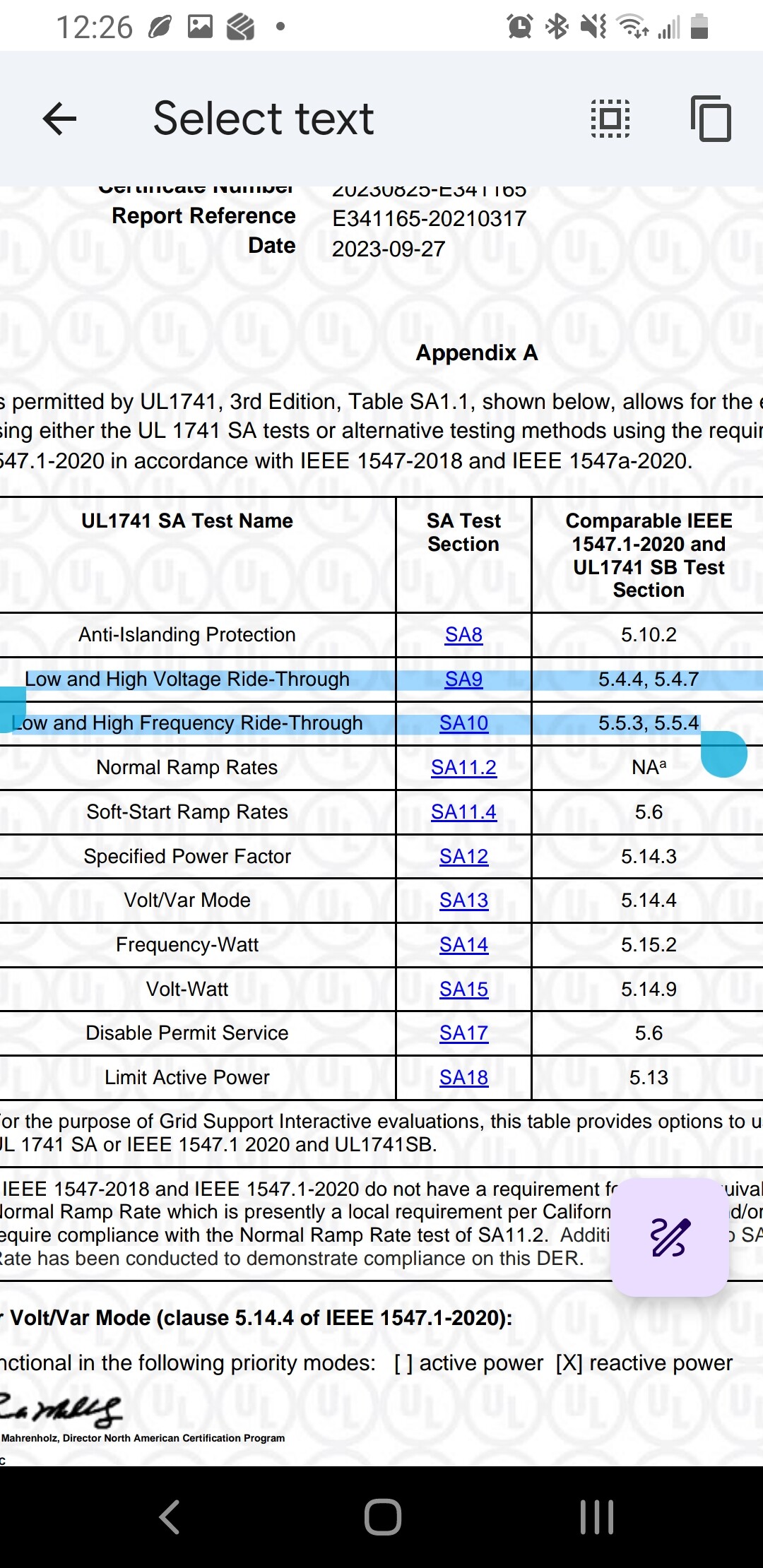

what about the ride-through capability?
https://enphase.com/installers/resources/ieee-1547-2018
great article.
IQ8GF-TB-0031-01-EN-US.pdf (32.3 KB)
DER-Ride-Through-Performance-Recommendations.pdf (1.3 MB)
