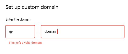

However, the custom domain feature of Google Sites only allows you to use a subdomain, like www.domain.com, rather than a “naked domain”, @, “apex record”.

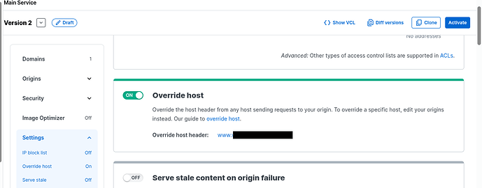

I made a new account under Fastly’s trial tier and added the apex domain to it (and put their A record IPs in the registrar’s DNS settings), and got them to create a certificate for it. Then I created a Service under that domain entry, with the Host: field set to www.domain.com.

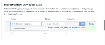

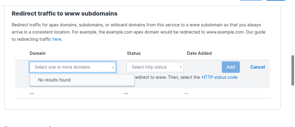

Fastly has a feature they call “apex redirect” which sounded promising, but I wasn’t able to figure out how to get it to do what I needed.

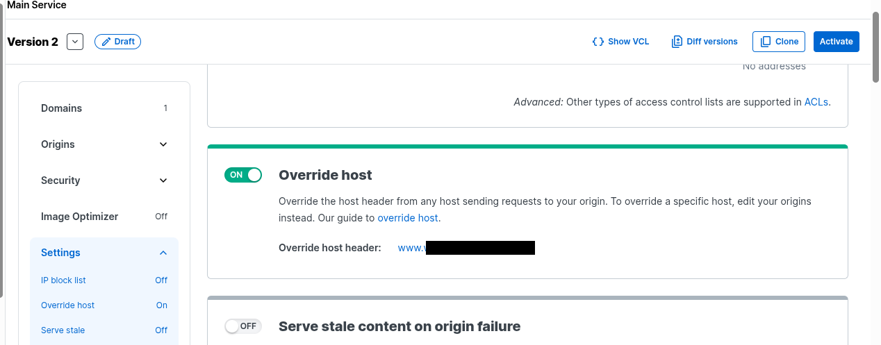

No matter though, because what I really needed was their Override Host setting.
Now everything works seamlessly.
