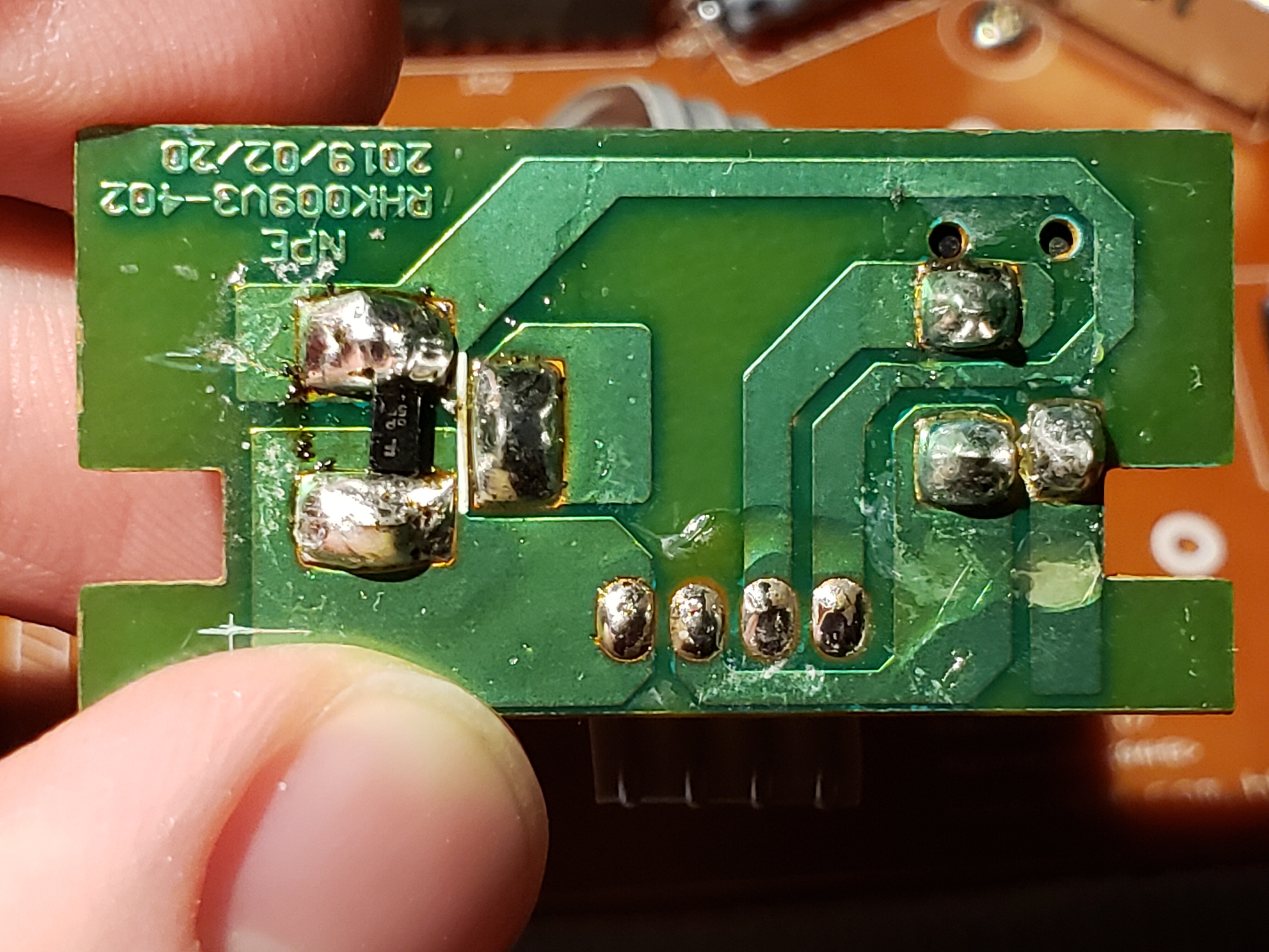

I installed a TVS diode, a Littelfuse Inc. SNF16A, across the output going to the vibe motor.
I scratched a + where the high-side of the vibe power is. This is a unidirectional TVS; the line on the diode is facing +.
This doesn’t do anything about EMC from sparks nearby, common-mode ESD, or ESD transients coming in through the buttons.
But it seems to have done the trick reasonably enough; I tried make it latch up again, and it hasn’t done so.
So, this didn’t work. A few days and a few sparks later and it latched-up again.
