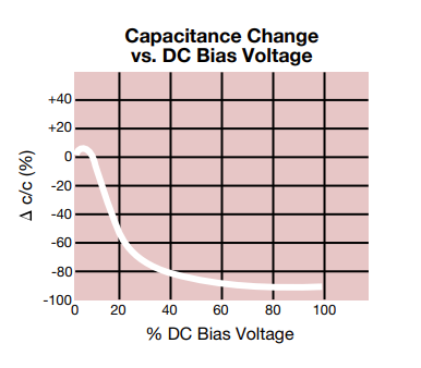

nice article on MLCC voltage derating.
C0G/NP0 dielectric is the best, harder to get in large values
